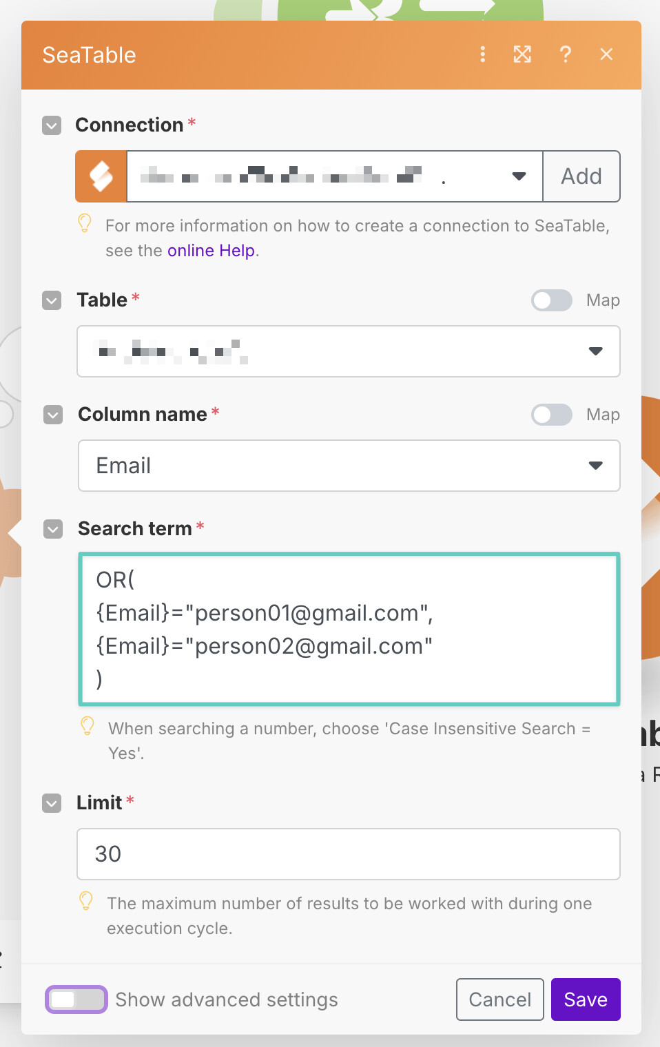

Hello, I’m not sure if this explanation is what the OP was looking for but let me give it a try.
I have a Make Scenario where I need to update a field in a couple of different rows in SeaTable. But first, I have to search for those two rows and the only info I have available are 2 email addresses. I need the rows for both of those email addresses.
Since I can search in the specific column that I want (in this instance “Email”, I should be able to find those two addresses as they are in the Table I am searching.
If I were using Airtable, that search would look something like this:
OR(
{Email}=“person01@gmail.com”,
{Email}=“person02@gmail.com
How do I do the same in SeaTable? I’m attaching an image of what I want to do.
So yes, this is a regular type of search that can be done in Airtable, how is it done in SeaTable?
Thank you so much for reading, and my apologies if I should have posted this as a new enquiry, but it makes sense to include it in this one since it is actually the same subject, which doesn’t yet have an answer.
Thanks
As already described, I see two options:
  • create a formula column in SeaTable and inside this formula column, search for the two emails and just return “found”, “not found”. Then you can search for “found” in Search term.
  • try to use the "SQL-Query endpoint like this:
SELECT email FROM table WHERE email IN ('person01@gmail.com', 'person02@gmail.com');
or
SELECT email FROM table WHERE email = 'person01@gmai.com' OR email = 'person02@gmail.com';
Thank you, that makes sense and I understand what you are saying. The piece that was missing for me was that there are two types of searches. One a normal find a row and the other was the SQL search.
Problem solved for me - and it works beautifully (it’s been a while since I used an SQL search!)
Thank you so much.
