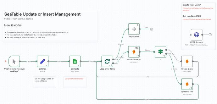

SeaTable and n8n - my experience I would like to share
Setup:
  • SeaTable Cloud
  • n8n self_host
Comment:
Just tested SeaTable with n8n, …. exploring how to insert/update records. My feedback here on LinkedIn.
