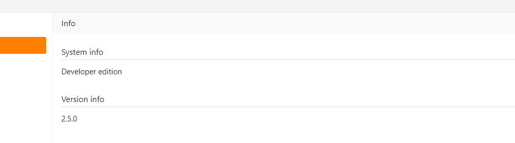

@Karlheinz i am using 2.5.0
latest docker image is still 2.5.0. So I’ll wait for your deployment to get the 2.5.4 and make test with n8n
Thanks for the reply. So you are using the Developer Edition (DE). I’m not sure if the DE will be upgraded to 2.5.6, perhaps then direct to 2.6.0. In this case you’ll have to wait until the middle of December.

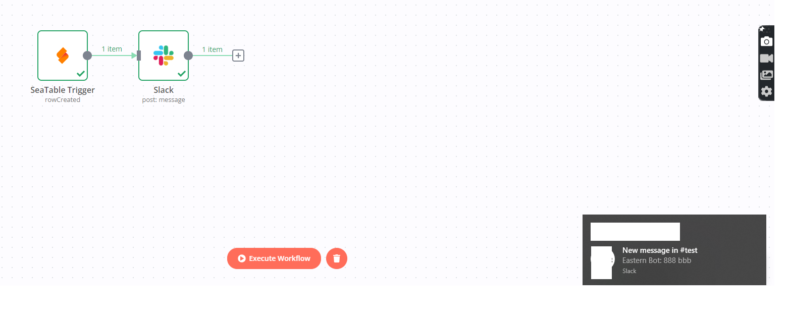

Hello @Karlheinz , I have updated to 2.6 DE and tried the trigger node and it is still not working.
when i manually execute the workflow, it work by showing the 1st row data.
However, when i activate the workflow, my slack notification is not responding after new row is created by filling up form.
I tried setting “poll time” to every minutes, and it still does not work.
