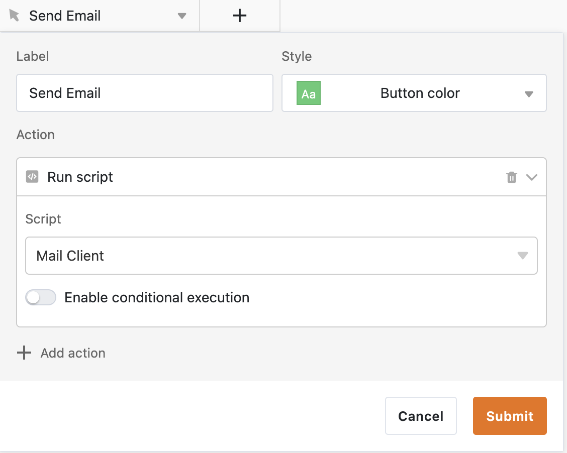

Then add a button that triggers the script:
now when clicking the button:
my email client opens with the email addresses in the specified column:
Hope this helps to get you started.
