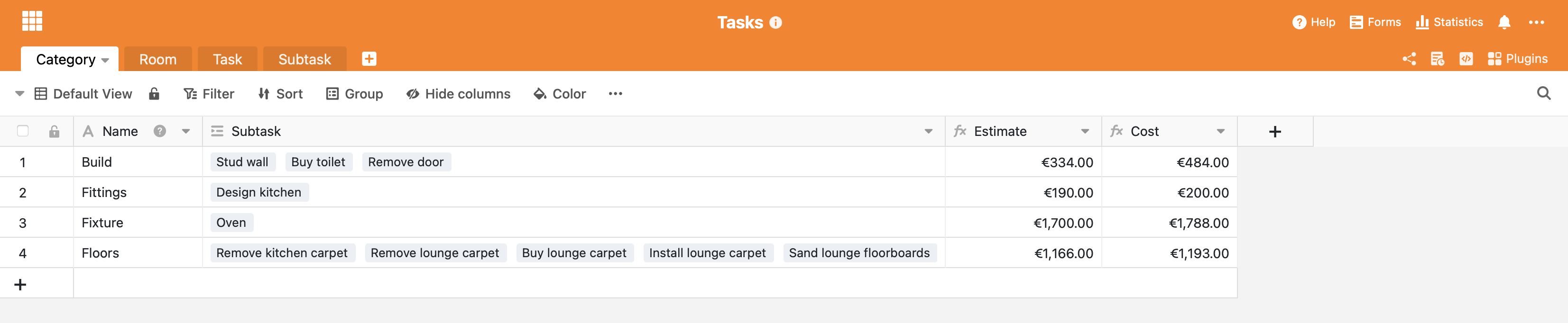

I have this working using the Subtask table to enter all the data, with linked fields adding data to the other tables. The Subtask table has linked fields for Task, Room and Category.
My question is this. How do I display what room a task belongs to in the Task table? Or how can I display what Categories a Room belongs to in the Room table? These items are already Linked from the Subtask table so I’m not sure how I accomplish this.

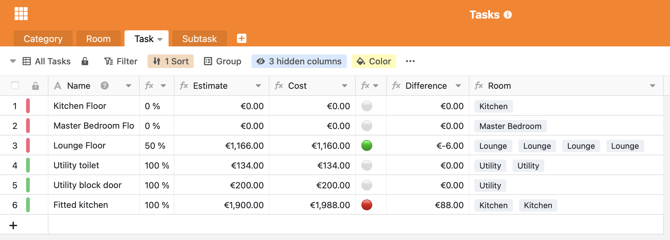

Now, let’s apply this to your case: Add a formula column in the task table. The formula shoud be {Subtask.Room.Name}
Can you try this out?
Thanks! I must have tried a million ways but not that.
The only issue is that it returns multiple Rooms that are the same. Probably 1 for each time the room is added to a Task. Is it possible to just show 1?
Glad to hear that it worked. (Could you please mark this thread as solved.)
The repetition of the room name in the linked column is a consequence of your data structure. SeaTable returns the room name once for every subtask in a task. Look at Lounge Floor: It has four subtasks and the room name is shown as many times.

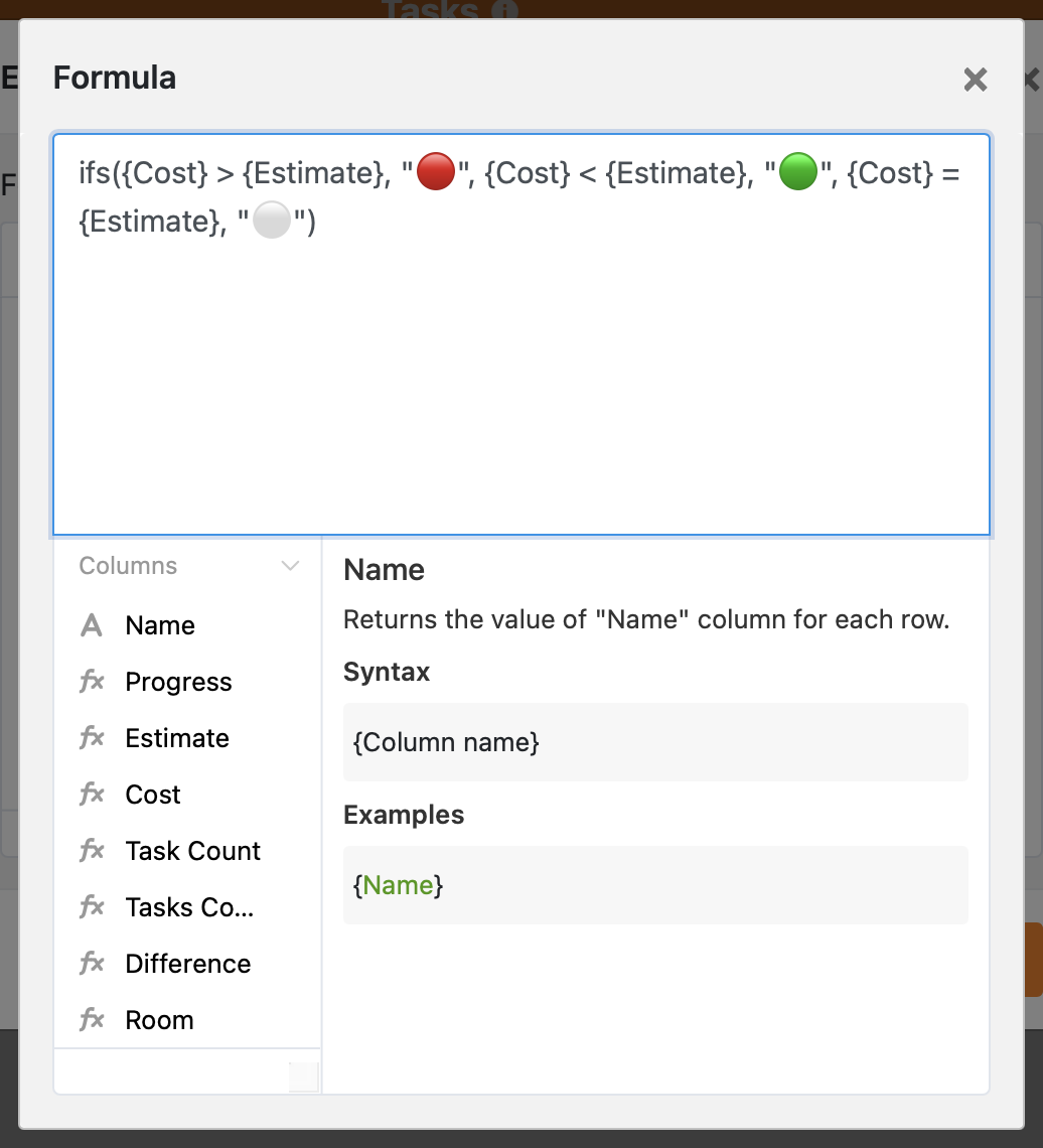

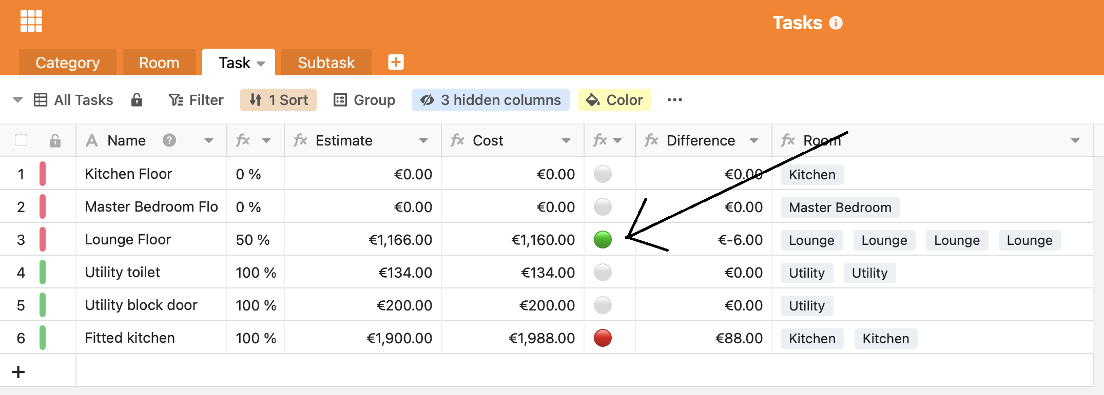

But I also have a question for you: I thought I knew all of SeaTable’s features, but apparently I do not! What is this??
I was never the best with data structures. As soon as things get nested a few times and data thrown around different places, my brain gets confused.
The dots aren’t really a SeaTable feature but rather me using emoji in a function;
