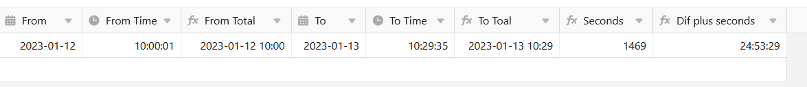

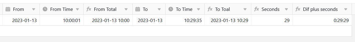

I tried it right now and I could only get it working by combining formulas.
For example:
  • The columns “From Time” and “To Time” are of type duration.
  • “From Total” and “To Total” are formulas: {From} + {From Time}
  • “Seconds” calculates the difference in seconds, so I have to devide it by 60: dateDif({From Total}, {To Toal}) / 60
  • And at the end you can combine it to “Dif plus seconds”: dateDif({From Total},{To Toal}) + {Seconds}
So you can play around with the date values and combine it like you want. But you will always end with several columns.
A function to format a iso datetime value with timezone would be a big benefit to the application. Maybe some day in future they will implement it :slight_smile:
I think it didn’t work with different days, but it will work if it is the same day :smiley:

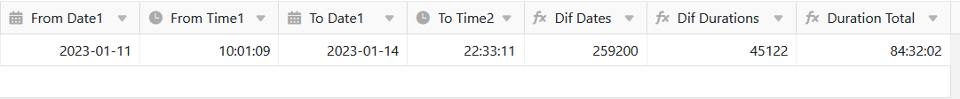

I think I got the wrong solution :smiley:
This should do the trick:
  • Dif Dates: dateDif({From Date1},{To Date1})
  • Dif Durations: {To Time2}-{From Time1}
  • Duration Toal: value({Dif Dates}+{Dif Durations}, ‘duration’)

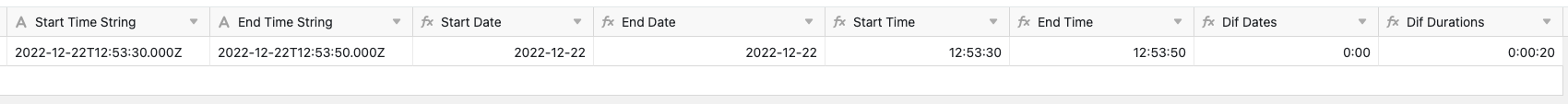

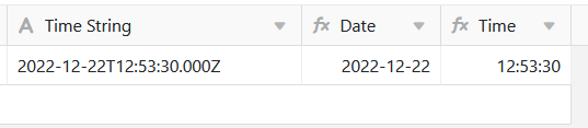

Hm, I understand. What about import the datetime value into a string column and then convert it into date and time columns?
grafik
For the date column:
date(left({Time String}, 4), right(left({Time String}, 7), 2), right(left({Time String}, 10), 2))
And for the time column:
(left(right({Time String}, 13), 2) * (60 * 60)) +
(left(right({Time String}, 10), 2) * 60) +
left(right({Time String}, 7), 2)
You have to set the time column data type to duration with seconds.
did the exact thing also
your “Time” is a formular generating a string, which is not possible to get the dateDiff from
What formula did you put in Formula 3?
this was important. was not aware that this is possible.
works now. what an effort for what is one simple formula in Airtable…
