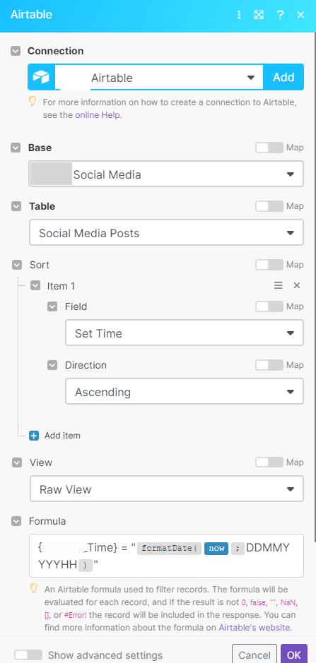

I’m looking to post to social media for the base. I had it working in Airtable, where it would fire every hour and check whether a post was ready via make.

In Airtable, I was able to do a formula that did this accurately to the hour.

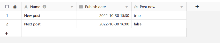

Let’s see if I got it right. You create new rows with a specific publish date like 10/30/2022 16:00. An hourly script should identify this row and post it to some social network?
If thats the case, you could create a formula column “Post now” like…
Containing formula:
and(
date(year({Publish date}), month({Publish date}), day({Publish date})) = today(),
hour({Publish date}) = hour(now())
This returns true or false in case it fits the current hour. Then you create a new view with a filter on the row “Post now” that only shows “Publish now” = true (ist gleich = equals).
