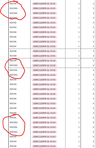

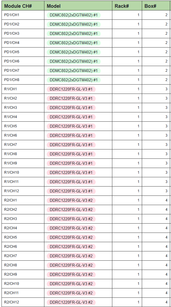

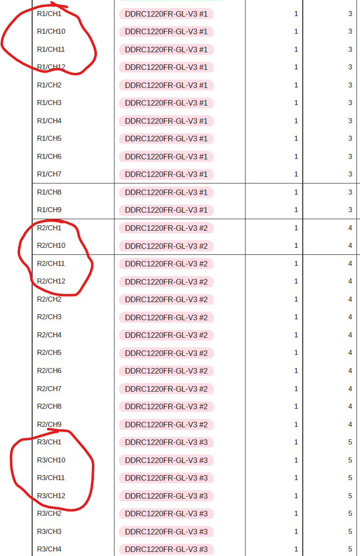

The sorting in the page design seems okay in the page designer, but when printing PDF its wrong.
I have 10, 11, 12 coming after 1, instead of 9. Screenshot 1 is from the designer, screenshot 2 is from the PDF.

  1. This is from page design, inside the page design plug in. When doing a PDF export (the top right hand side button).
  2. It’s a text type column.
This is a limitation in sorting for text column. When you export the PDF, the list of rows is sorted at the server side using the dtable-db component, which does not support sorting with mixed text and number.
I see. So if I change it to numbers only it will be okay? (I’ll need to change how I do a few things but maybe I can work it out)
If you change it to numbers, the sorting should work.
