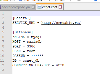

This is the relevant error message. It seems that you database container is called mariadb but in dtable-storage-server.conf you still have host = db. Change that and restart SeaTable.

Please check the other configuration files and search for host = db.
I understand correctly what should be
host = mariadb ?
I don’t understand your question. Check the name of your mariadb container and then add this name to the configuration files. Otherwise SeaTable will not work.

From your logs, two problems are immediately visible:
- [fatal] Failed to setup dtable-db: private_key must be specified in the config file
- MySQLdb.ProgrammingError: (1146, “Table ‘dtable_db.dtable_seafile_connectors’ doesn’t exist”)
Therefore, you have two things to do:
- Make sure that the
private_keyis correct in the dtable_server_config.json and that the value is the same as in dtable_web_settings.py - in your dtable_web_settings.py I assume that your
mariadbconfiguration is wrong.
