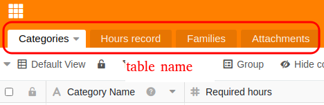

table_nameshould be the name of your table (which is inside your base), but not the name of your base.

And for the table_name : it looks like you have used a base name, not a table name:
This call works:
curl --location --request GET \
'https://table.seafile.com/dtable-server/api/v1/dtables/f492ab5da7964ef5909db491c9a056a0/rows/?table_name=Table1' \
--header 'Authorization: Token <my base's access token>'
