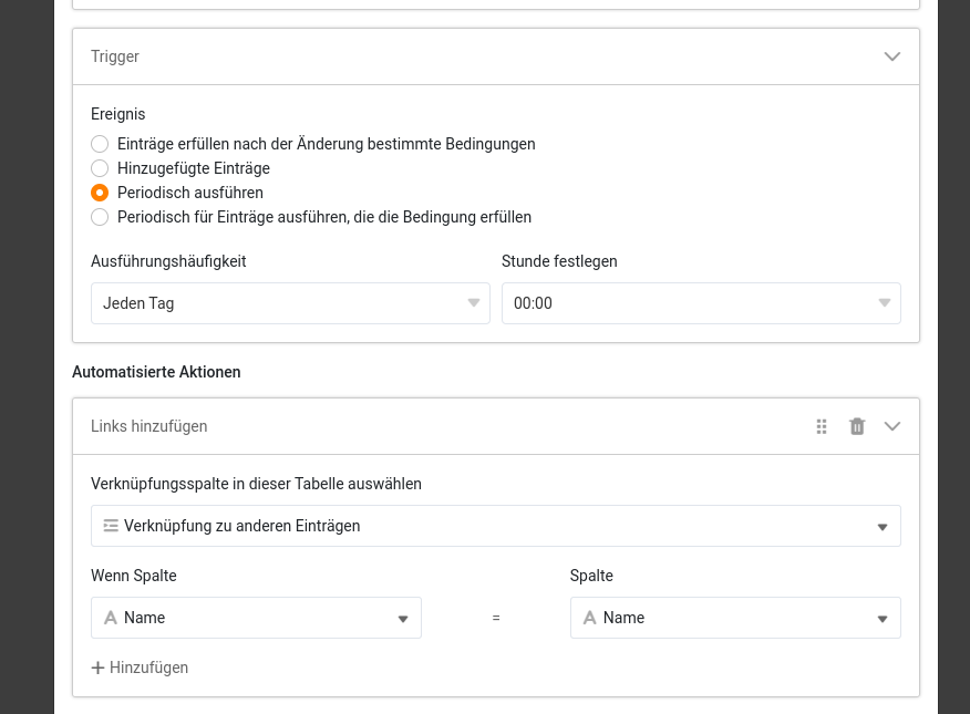

Hey, due to an issue with the automation of SeaTable, and because it doesn’t work automatically, we have to manually create (or update) a link between two tables every day.
To ensure this works even when our responsible employee is unavailable, I would like to write a Python script to handle this task.
