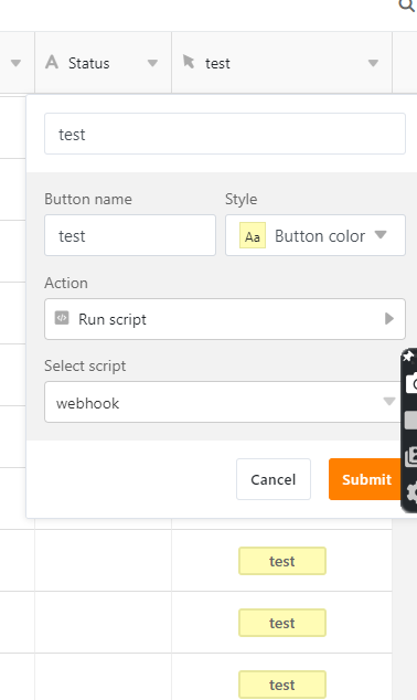

I create a button and link to the script.
However, when i press the button, nothing is send to webhook…

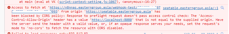

You can use Chrome’s debug console to check whether you have sent the request.
@daniel.pan thanks for the guide. it is working now…
I need to add the following
mode: "no-cors",
as i am getting the following error. ( by looking at chrome console )
so my final script become,
