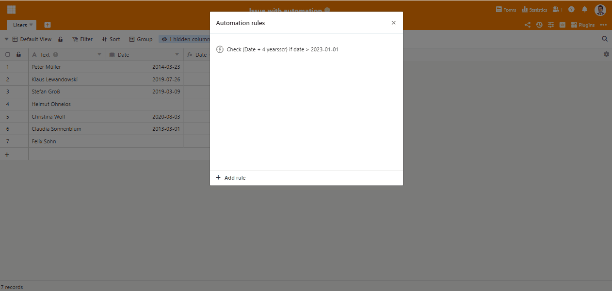

I cannot reproduce your issue.
AutomationFormulaDates

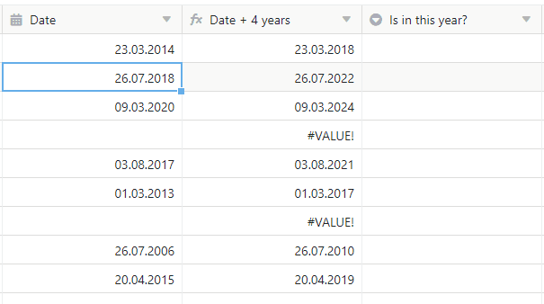

As you can see, it works like a charm.

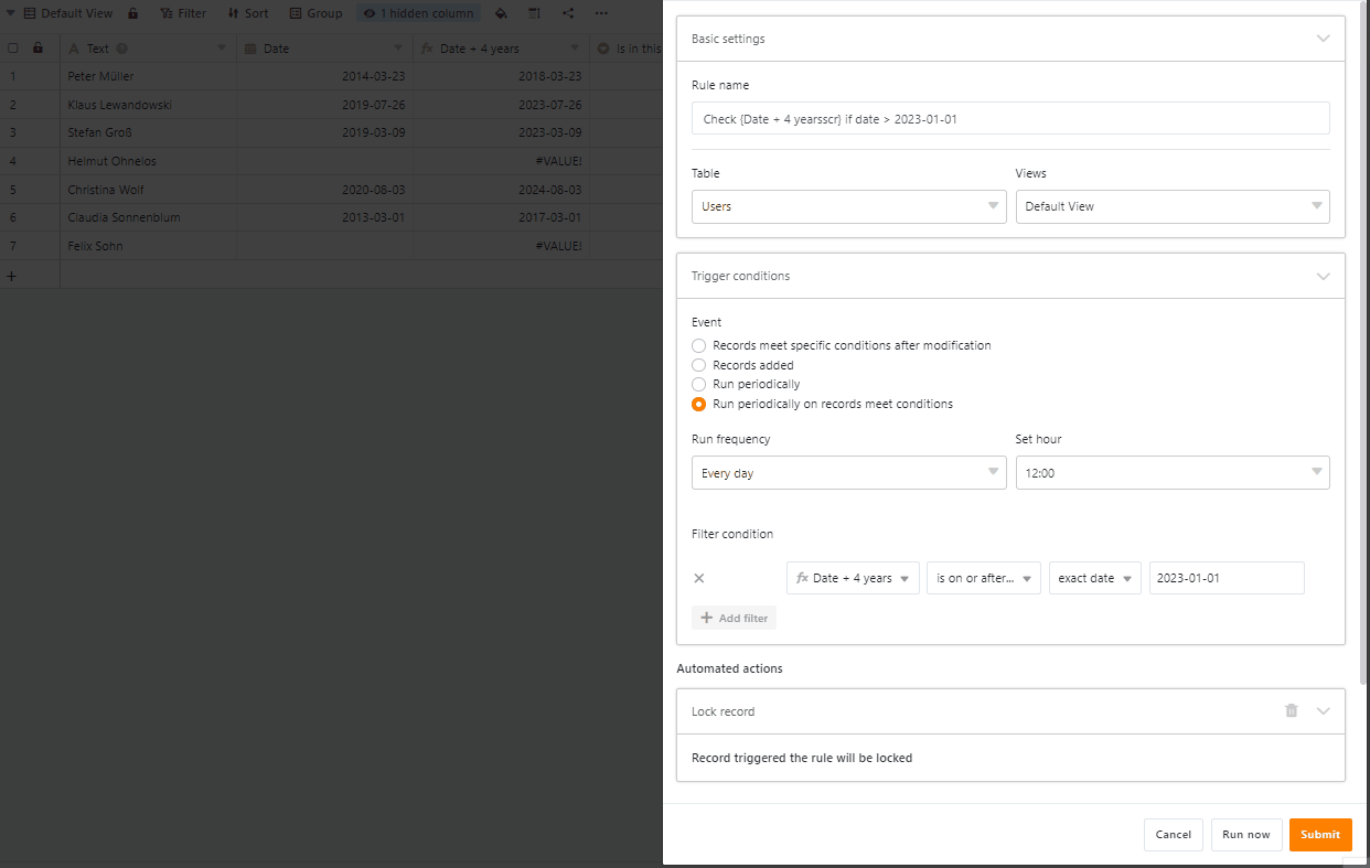

This is my automation rule:
I take the liberty of changing the title of your post because there is no bug. I also took the liberty of re-categorizing your post.

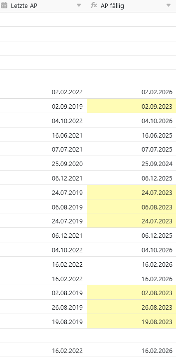

Alright, here we go. Screenshots:
As you can see, the yellow ones are within this year.
  1. now, second screenshot the rule:
And it does not work.

In contrast, If I change the formular column to be a real date column and set the dates manually, the exact same rule works.
Differences to your sollution:
  • German Date format
  • Empty cells in the column, as not every device needs that date.
From my pov, that is a bug, not a feature. :wink:

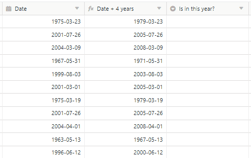

Also works with German date format and empty cells:
AutomationFormulaDates1
I guess this rule is the issue:
The rule only checks once a month. How often do you expect the automation to trigger?

I use the event “Run periodically on records meet conditions” (like you) and I monitor a calculated column (like you). The triggered action is “Lock row”. When testing the automation by hitting “Run now”, the correct rows get locked.
AutomationFormulaDates2
Please understand that I will not test further unless you can provide a case that I can reproduce reliably.
