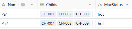

I have 2 tables linked together :
Table Parent :
Table Childs :

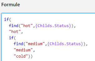

In Parent, I want MaxStatus to be dependent on the value of the Childs Status.
Because Formula Link (FindMax) is not ok with text, I used formula
The result in the table Parent is ok MaxStatus is ‘hot’ everywhere
What is not ok is when I export the data with code :
there is one ‘medium’ !

So to summarize your question: You get different results from the seatable webinterface and python code?
In the web interface you get 2x hot and from your python code you get 1x hot and 1x medium?
Is that your issue?
Remi
December 10, 2025, 2:42pm
3
Yes that is correct : different output between webinterface (hot + hot) and Python code (medium + hot). We noticed also same behaviour with API.

Hi @Remi ,
I was able to reproduce your problem, even if I can’t explain it . I just wanted to give you a simple workaround (of course this issue still needs to be solved however), in case this problem is blocking you but maybe you already found it:
Create a Childs status lookup-type column in your parent table to get the status of each linked child
Adapt your MaxStatus formula by replacing {Childs.Status} by {Childs status} everywhere
Doing so, Python will retrieve the same value as the webinterface
