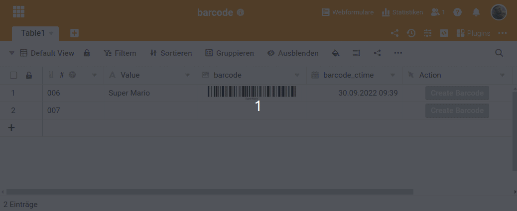

Hey everybody,
here is a new tutorial how to create a barcode within SeaTable with python and a button column:
barcode generation
Here is the complete python script I used. Just copy and paste it and adapt it to your needs. Scroll down if you want to read where I explain the different components of this script. By the way, you will need a free account at https://pdf.co/.

Allow me to explain the script in more details

SeaTable needs to know in which row you would like to operate. Either you execute the python script with a button column or you execute it directly in the python editor. In both cases, you should get the “right” row-id:
  • if you use the button, it should work with the row where you pressed the button
  • if you execute it from the editor, you should define the row_id you want to use.

Here is the result
