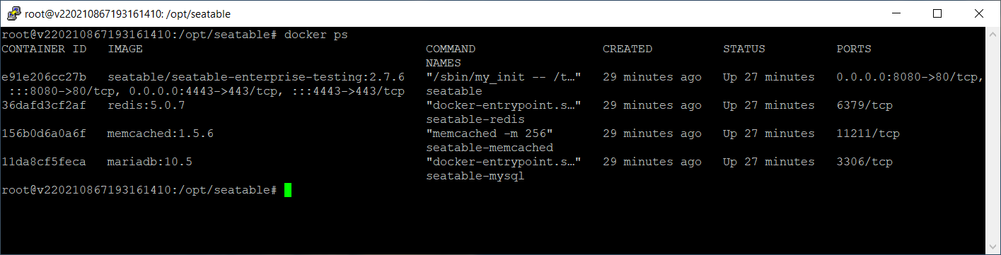

Running Docker containers and listening ports
