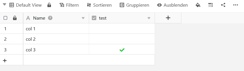

The table could look like this:
You have to add the code as python script:

Then add an automation rule that focuses on the column “test” wich holds the default value checkbox. At the moment it only supports boolean (check box) column types. Save it!
Now, if you want to change the default row just click the box in another row, wait a few seconds and the old value should be reset to false (unchecked). This is much easier than searching for the one selected row you want to uncheck ![]()
