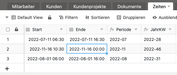

Hello SeaTablers,
I’m having a problem updating a row via Postman.
I use the original SeaTable environment. The update works “almost” wonderfully, only the date arrives without the time.
It is always 00:00 (blue frame) no matter what date format I give. How did you solve it. I look forward to your feedback.
Bildschirmfoto 2022-11-16 um 18.45.13
Hi @cahore.
You have to format it like “YYYY-MM-DD HH:MM”.
Works, thanks so much. :star_struck:
Perfect, My pleasure :slight_smile:
