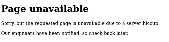

2. Upgrade from 4.0.7 to 4.2.11
This upgrade made all pages return a 500 with generic error (see below).
Scripts Run:
  • 4.1
  • 4.2

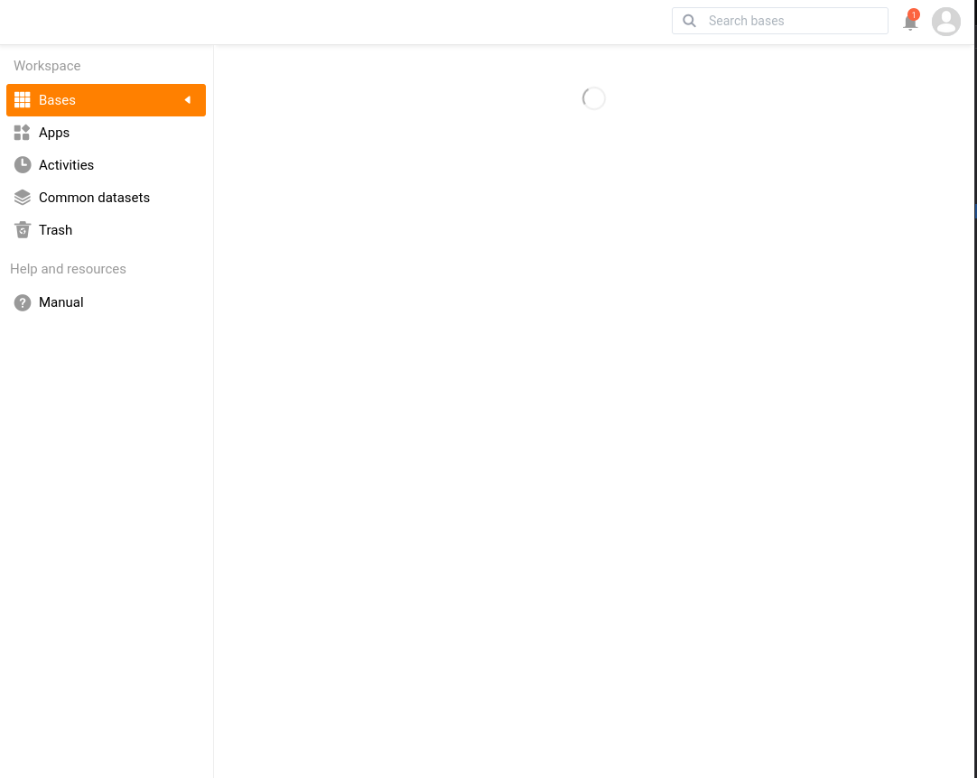

Rollback to 4.1.9
This allows seatable to load and I can login, but the home page will not show any bases. The /api/v2.1/workspaces/ call returns a 500 with the same generic message as above and the home page looks like this:
Rollback to 4.0.7

Problems like you describe are most likely connected to problems with the mariadb-database structure. Some table columns does not exist or have the wrong format.
Or you have some really strange configuration problems in dtable_web_settings.py.
Here is my advise:
Run the updates again and execute the following command to get error messages from SeaTable:
tail -f /opt/seatable/seatable-data/seatable/logs/dtable_web.log
Then try to open SeaTable webinterface. You should get any kind of error message.
