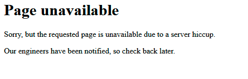

After trying to access the front-page i see this “hiccup” error message:
grafik

Please follow these upgrade instructions: https://manual.seatable.io/upgrade/upgrade_manual/
Hi,
thanks i tried that, but it seems, that the database is empty:
mysql: [Warning] Using a password on the command line interface can be insecure.
ERROR 1049 (42000): Unknown database 'dtable_db'
I’m wondering if i dumped the docker volume. But actually i’m mounting a host folder.
If i can’t find any backup of my db. how would i continue? Is there a script to init the db?
Did you use a custom domain? If so, make sure to configure the domain in dtable_web_setting.py. See here: dtable_web_settings.py - SeaTable Admin Manual
Did you start from an earlier version than 2.3? If so, perhaps was the upgrade to 2.3 already problematic. See here: Extra upgrade notices - SeaTable Admin Manual

It seems like i need to reinitialize my database (mysql).
After diggin a bit into it i found out that you can also do some db init using the seatable script in /opt/seatable/scripts.
/opt/seatable/scripts/seatable.sh init-sql
After successfully running the script i had to create a super-admin and was able to login. Unfortunately all my data is gone.
I’m just wonderung why it was gone afterwards. I think the folder that i mounted in my docker-compose was empty. I think I’ll check my backups.
