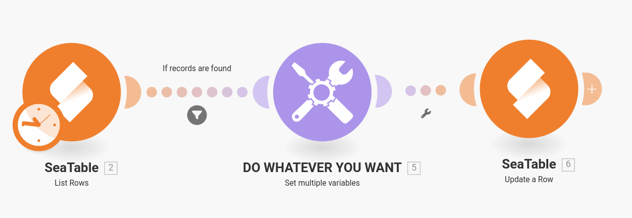

I would do this differently:
The scenario
  • runs every x minute
  • it lists all rows of a specific view (I will explain later on)
  • it will update the rows and mark it as processed.

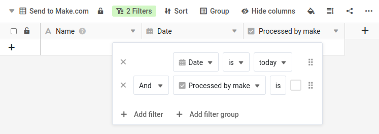

The Base
  • create a view with filters that only contain the entries, that should be processed. Therefore I decided to show only “todays” entries and that are not yet processed.
The Idea
when the Date value is equal to today, a row will show up in this specific view. The Make.com Workflow will process the row and the last “update” sets the checkbox to . With this the row vanishes from this view and will not be processed twice.
Very nice and simple idea. Thanks.
