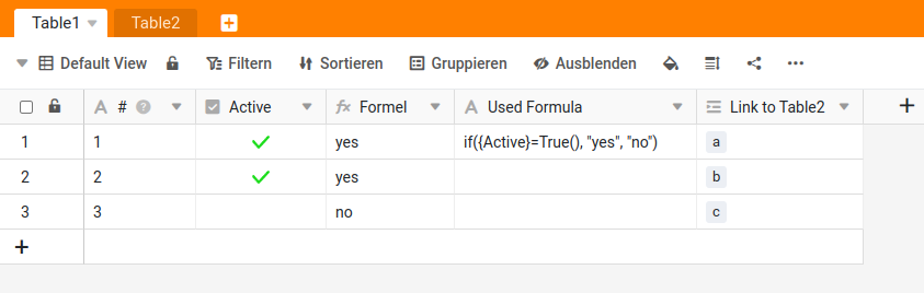

Sorry, I don’t get your point. Please look at these screenshots:
Can you explain me your problem?
Thank you for showing the screenshots with the formulas. The problem was actually in the syntax!
As you can see in the screenshots, the syntax is true() in table 1 and ‘True’ in table 2. This was not clear to me. I assumed that a query for Boolean values must always be entered in the syntax true() or false().
By using ‘True’ for a look-up column in table 2, the formula works as intended and without an error message.
