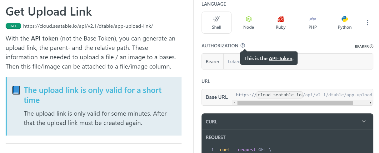

I take the liberty of pointing out that the API reference calls for the API token for authenticating the request:
