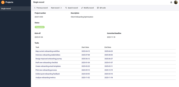

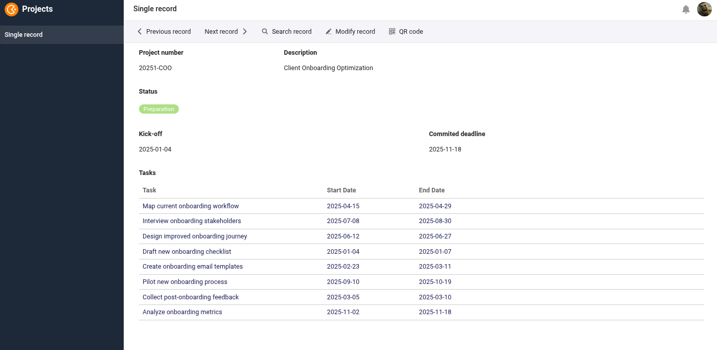

Have you tried a single record page? Add the link row as a table.
Would look similar to the screenshot below:

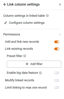

And, generally speaking, did you configure the link column’s properties.
