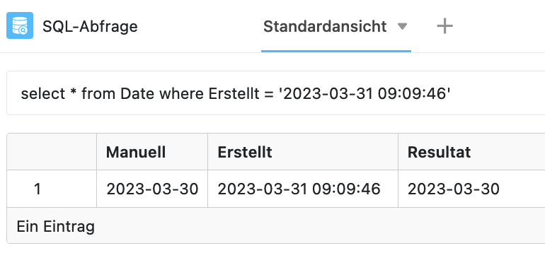

The thing is when I get a result from SQL it is ok but when the Query in executed via Python script I get a result like this ‘2023-05-01T00:00:00Z’ and I want to convert it to 01/05/2023 because the date format in table is DD/MM/YYYY

SELECT Event start FROM Collegiumis not a date value.date Valhas to be one word- You should read the manual on how to use queries
