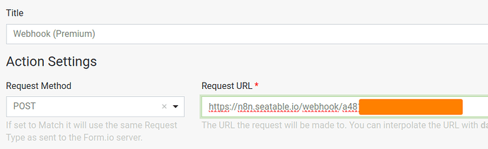

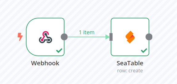

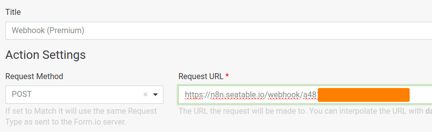

Why not do it this way??
If you need more functions with a web form and if you want to avoid the coding work, I would recommend taking a look at https://n8n.io.
n8n is an automation platform that is great for connecting various systems together without coding. Still, you have a lot of control of the data and the data flow.
A German city uses the following combination for many civil processes like “Anwohnerparken” (parking permission for residents) or something that is called “family card”.
They decided to use form.io because it offers multistep web forms, advanced input validations, etc.
The connection of form.io, n8n and SeaTable is simple. Form.io just sends a webhook after each submission, n8n receives the webhook and writes it to SeaTable.
Probably aidaform can do the same or n8n can get the responses without a webhook but with an API-request.
Here are some screenshots:
1. form.io sends a webhook to n8n.
2. Super simple n8n workflow - receiving the data and save it to SeaTable
For sure this could be improved with a check for updates etc…
