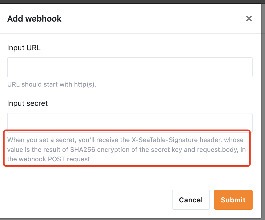

The way of passing the secret has been changed for security reason.
You should now check the signature as following in your webhook receiver:
Yes I have read that, I’m just not sure how I combine the secret key and request.body to be honest. Do I encrypt both?
The following Python code is an example:
