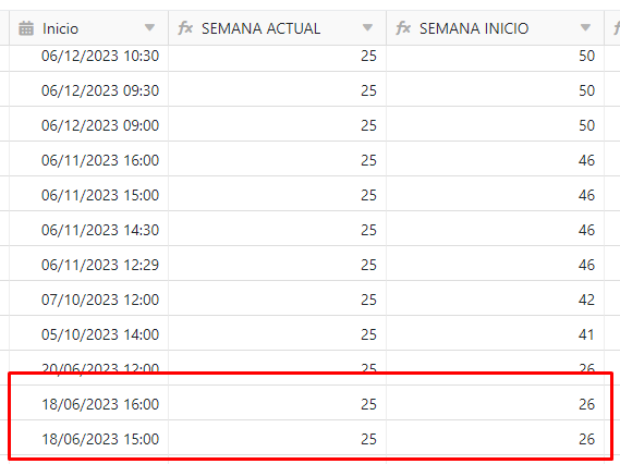

Screenshot_91
In the column “SEMANA INICIO” I’m using this formula: weeknum({Inicio}, 11), and as you can see in the red rectangle the actual week is 25 (16/06/2023) and the event week should be (18/06/2023), but it is counting it as the next week (26), because is Sunday.
Is something wrong?
Yeah, I see. weeknum uses the information of the first week of the year. Even if the 31th of december is a Saturday it will be count as week one of the year. The function isoweeknum instead recognizes it as week 52, so it is the 1st on the Sunday.
You should use isoweeknum.
