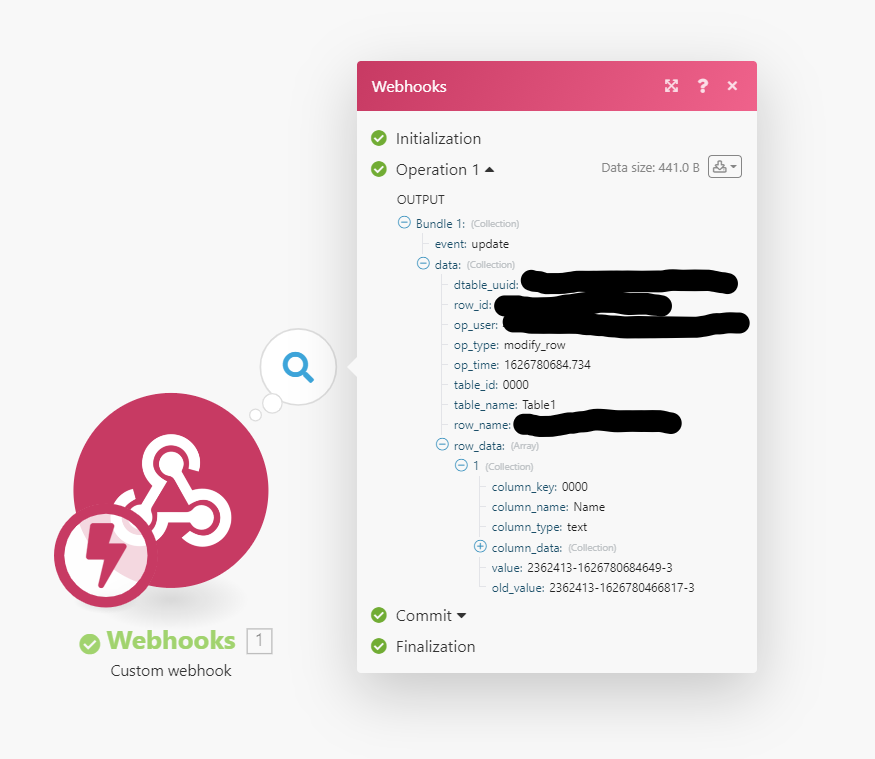

I can show you how a call looks like:

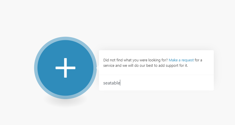

Hey cdb,
Thanks for your answer!
But, I think it is not out (at least not for everyone). I can only find this reference:
https://www.integromat.com/en/help/app/seatable
But as you can see there is not any achievable modul out yet:
Br,
Tamas
Hey @cdb,
It would be pretty nice to have some kind of documentation of when the webhook triggers and the data structure sent upon firing. This will help us so much to do our custom integrations.
Also, I read on your roadmap for 2.2.0 that you are developing automation rules. Does this mean that the webhooks will be improved? I imagine that we could trigger them only when a specific rule is met (something akin to the notifications triggers).
Regards,
Hey @sirland , for your latest questions:
The basic data structure is:
"event": "update", // currently only 'update'
"data": {} // The updated base data, see below
The data object looks like this:
"dtable_uuid": base_uuid,
"row_id": row_id,
"op_user": username (or user_id),
"op_type": op_type, // insert_row, delete_row, delete_rows, modify_row, modify_rows
"op_time": op_time,
"table_id": table_id,
"table_name": table_name,
"row_name": row_name,
"row_data": row_data,
"op_app": appName // If the base has been updated via API Token, then the op_app will be the app's name of that API
The automation rules doesn’t involve improvements in webhooks.
