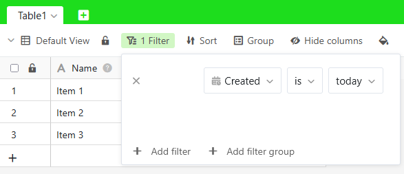

  4. Filter the view using the date column you have just created - use “Created is today“ or “Created is on exact date X“. All the records shown in the GUI are also retrieved via the API :white_check_mark:
  5. Filter the view using the date column you have just created - use “Created is on or before today“ or “Created is on or before exact date X“. The GUI still shows the lines created today, but the API retrieves nothing! :no_entry:

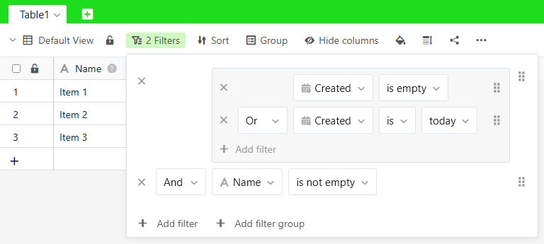

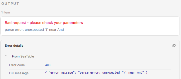

  6. Filter the same view with the date filter in a filter group like shown below. Again, the GUI shows the filtered rows as expected, while the API either returns “500 Server Error“ :no_entry:
    and sometimes this Error 400 :no_entry:

I confirm the first issue (your no. 5). I created a bug report.
Your no. 6 is a known issue that is going to be fixed in SeaTable 6.1. The problem emerges when you use “complex” filter rules. A complex filter rule is a rule using filter groups. The list_rows endpoint cannot handle “complex” filter rule.

I am experiencing the same as @abaer describes in (6), however I have no complex filters on the Default View (but this one fails with this exact error) and I do have complex filters on other views and I am able to retrieve them through the rows API. I am confused, but then it’s good to know it’s already a known issue.
@siax84 Maybe you could share the “views“ JSON data from the Get Metadata API endpoint of your base (anonymized if necessary). That should give some information about the exact nature of the views.
@abaer Your #5 will be fixed soon. In version 6.2, I can no longer reproduce the issue.
