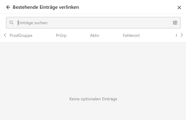

I am trying to use this in a “Link to other records “ column. If I choose a single select column to be my (dynamic) filter and select another single select column from the connected table, it seems that SeaTable won’t recognize equal entrys. Even when I export the options from table A and import them to Table B, so they are identical, no results will be shown (see picture attached). On the other hand, when I’m using “is not” as filter, it shows every entry from the other table.

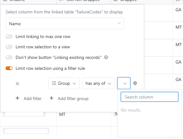

Hi Leo, I made some further testing and found that this won’t work with “Link to other records” as a filter either. There I can’t even select a column to compare with (see picture attached).

This is also a bug, we will fix it.

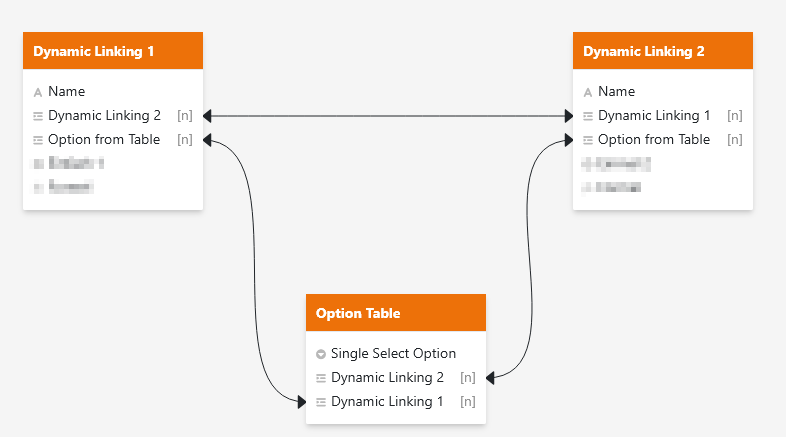

Trying out the solution I suspected from your quote above, I built the following, drawing the single option for both “dynamic linking” tables from the same linked table. I thought that maybe the options may be considered equivalent, having the same internal ID, because they were linked from the same “Options” table.
It failed because of the second thing that @niwi discovered: That link columns cannot serve as dynamic filters as well. Neither can link formulas, in case you wondered.
It was a bad idea in the first place, because in the backend (as opposed to Apps), we cannot restrict link columns to “linking only” (I think that was a feature request that reaches back to Seatable 3.x :wink: ). Therefore, everybody could add new options to the “Option Table”, and even duplicate ones.
