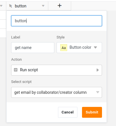

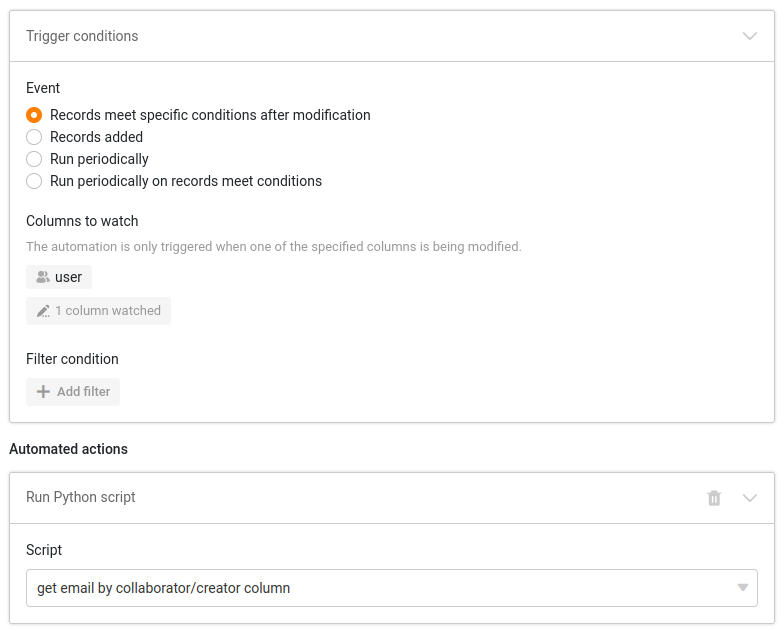

I solved this problem with a Python script that is executed via an automation every time the column user changes. Because automations are only available in the Enterprise plan, I also make it possible to use this script with a button.

Just save this script as a python-Script and change the input parameters at the beginning of the script. Then execute this script either via automation or via a button.
Here is the button:

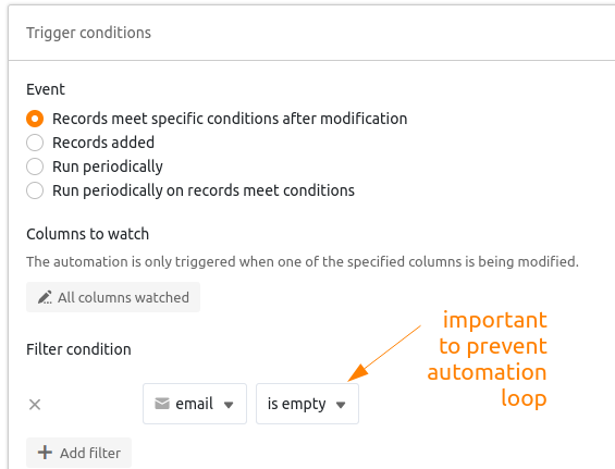

Here is the automation:

Important update from 29.8.2024
If you use an automation to trigger this script, please make sure that you only ran this automation once. Otherwise you will create an automation loop.
